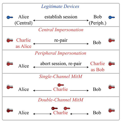

Indeed, they discovered 6 flaws including 4 novel ones that allow to do:
  1. Peripheral Impersonation (PI): The attacker spoofs a trusted peripheral (e.g., a keyboard), rejects the encryption request, then sends a crafted security request to trick the Central into re-pairing. This is the first attack to exploit pairing from session establishment.
  2. Central Impersonation (CI): The attacker spoofs a trusted Central and sends an unauthenticated pairing request → the Peripheral always accepts.
  3. Single-channel MitM: The attacker relays and tampers with re-pairing messages between victims, compromising the key offline.
  4. Double-channel MitM: The attacker runs PI against one victim and CI against the other, establishing separate keys with each.
These attacks are 0-click against devices without I/O (keyboards, mice) and 1-click (a simple Yes/No dialog) against smartphones and laptops.

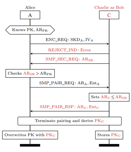

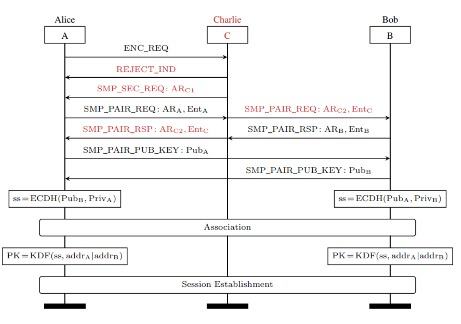

Attack 1: Peripheral Impersonation (PI)
Source: Paper BLERP: BLE Re-Pairing Attacks and Defenses, from Tommaso Sacchetti
(EURECOM) and Daniele Antonioli (EURECOM)

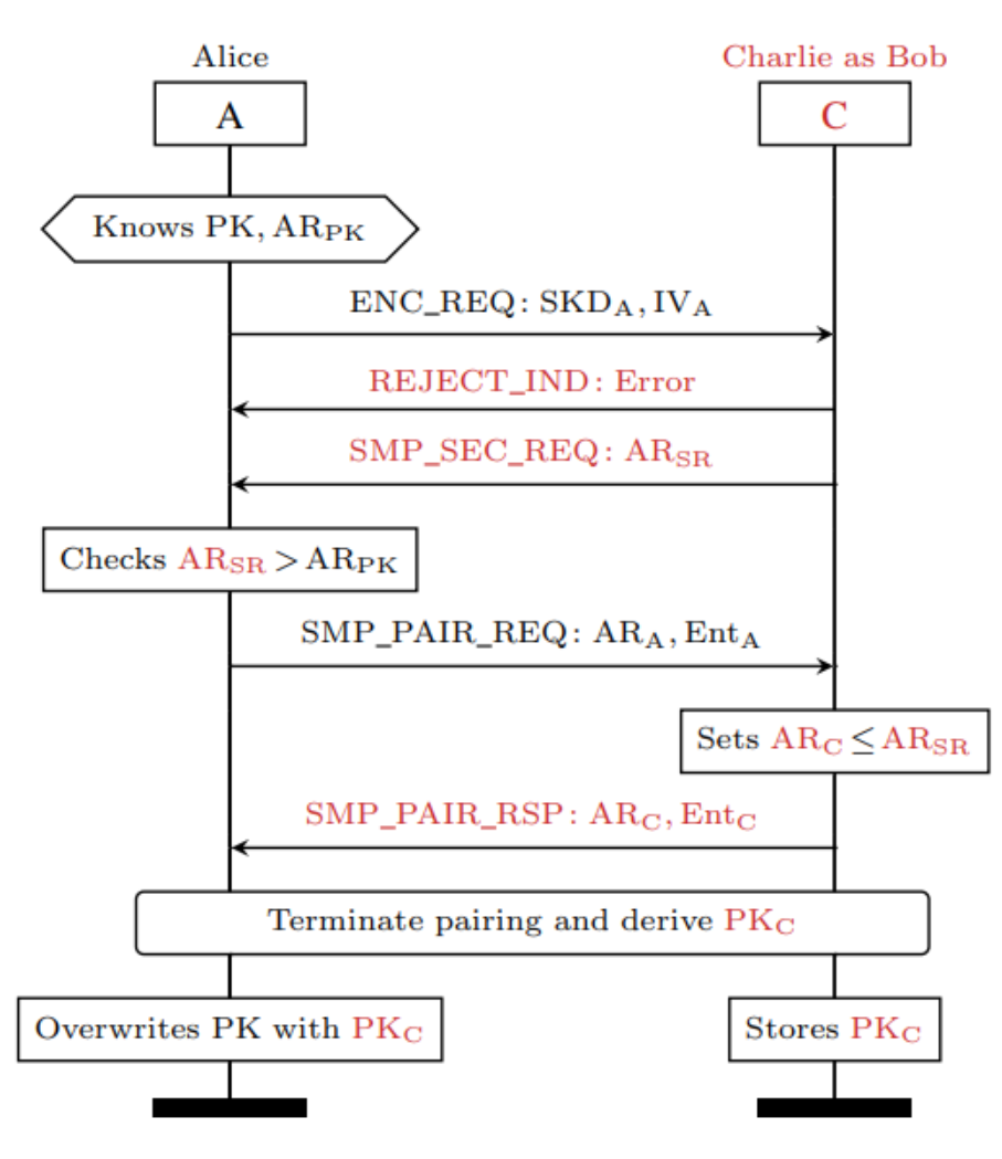

Alice (Central, e.g., a laptop) is paired with Bob (Peripheral, e.g., a keyboard). Charlie takes Bob’s place by spoofing his MAC address, name, and device type via advertisements. When Alice auto-reconnects and initiates session establishment by sending an ENC_REQ, Charlie doesn’t have the shared PK so he can’t complete it. Instead, he replies with a REJECT_IND carrying an error code like “Unsupported Remote Feature.” This aborts session establishment (V5).
Charlie immediately sends an SMP_SEC_REQ with a crafted security level (ARSR) designed to be higher than the stored ARPK. The standard’s decision tree (Listing 1 in the paper) says the Central must compare ARSR against ARPK. if higher, it initiates re-pairing. Charlie can easily craft this value without knowing the actual PK, for instance by setting the reserved-for-future-use bits high, or promising an upgrade from LSC to SC.
Alice, following the standard faithfully, interprets this as a legitimate re-pairing request from Bob and sends a SMP_PAIR_REQ. Charlie responds with a SMP_PAIR_RSP where he can downgrade the security level (V3, V4), the standard never requires the Central to check consistency between the security request and the subsequent pairing response. So Charlie can force JustWorks association, meaning no numeric comparison, no passkey, just a simple “Yes/No” dialog on devices with I/O, or nothing at all on devices without I/O.
Alice completes pairing with Charlie and overwrites her stored PK. Charlie now has full read/write access as if he were the legitimate keyboard. This is 0-click against IoT devices and 1-click (unauthenticated Yes/No) against smartphones and laptops.
A critical detail: none of the tested devices notify the user when encryption fails, even though the standard requires it. So the rejection + re-pairing sequence happens silently.

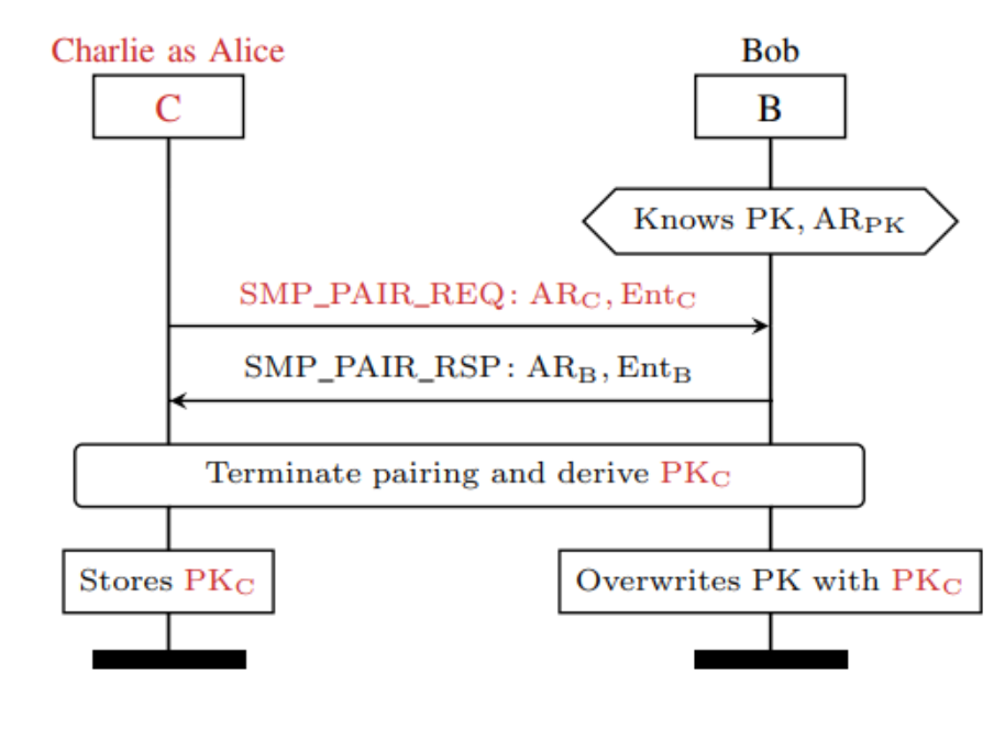

Bob (Peripheral) is waiting for connections. Charlie spoofs Alice’s MAC address and sends a connection request, then immediately sends an unauthenticated SMP_PAIR_REQ with a crafted security level.
The fundamental problem here is V2: Peripherals have no mechanism at all to authenticate re-pairing requests from Centrals. The standard only defines how Centrals should process security requests from Peripherals (the decision tree in Listing 1), but says nothing about how Peripherals should validate incoming pairing requests against existing keys. Bob just accepts, regardless of whether the new security level is lower than the existing ARPK.
Charlie can again downgrade the security level via V4 to force JustWorks, making the attack silent against peripherals without I/O (which is most of them, mice, keyboards, IoT sensors, fitness trackers). Bob overwrites his PK with the new one shared with Charlie.
This is particularly dangerous because peripherals are typically “dumb” devices with no display and no way to alert the user. The paper showed it working against Logitech mice/keyboards, Xbox controllers, and Garmin smartwatches.

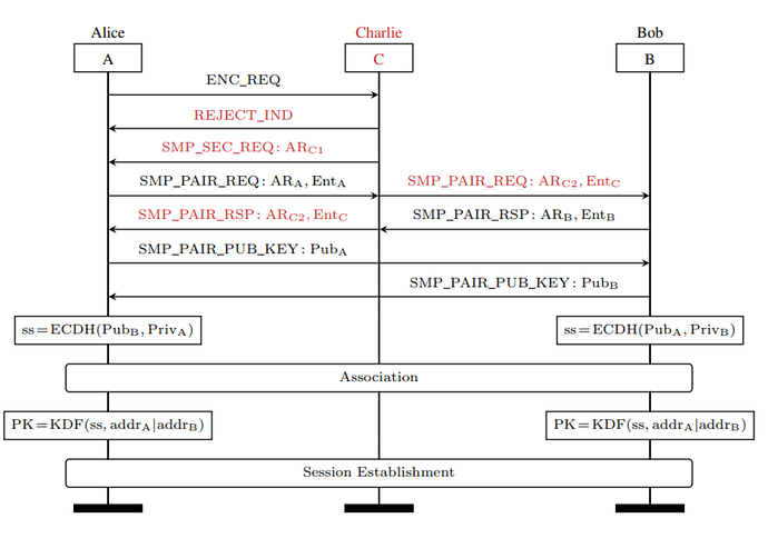

Attack 4: Double-Channel MitM
This is the full active MitM. Charlie runs PI against Alice and CI against Bob simultaneously, using two radio interfaces (two nRF52 boards in their toolkit). He establishes separate PKs with each victim: PKC₁ with Alice and PKC₂ with Bob.
After this, when Alice and Bob think they’re communicating with each other, Charlie sits in the middle: he decrypts traffic from Alice using PKC₁, reads/modifies it, then re-encrypts and forwards to Bob using PKC₂, and vice versa. This gives the attacker full real-time eavesdropping, injection, and modification capabilities.
The practical challenge here is the race condition, when the victims disconnect, Charlie needs to connect to the Peripheral before the legitimate Central does. The authors tested this and won the race 55% of the time without any optimization. With selective jamming of the legitimate Peripheral’s advertisements or aggressive advertising from the malicious Peripheral, this rate would increase significantly.

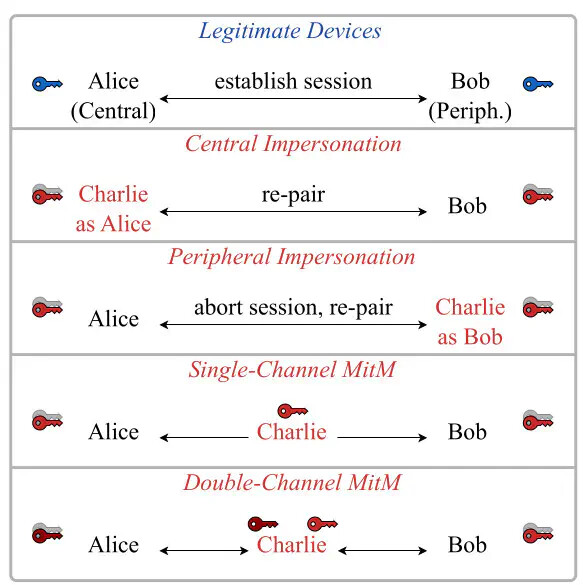

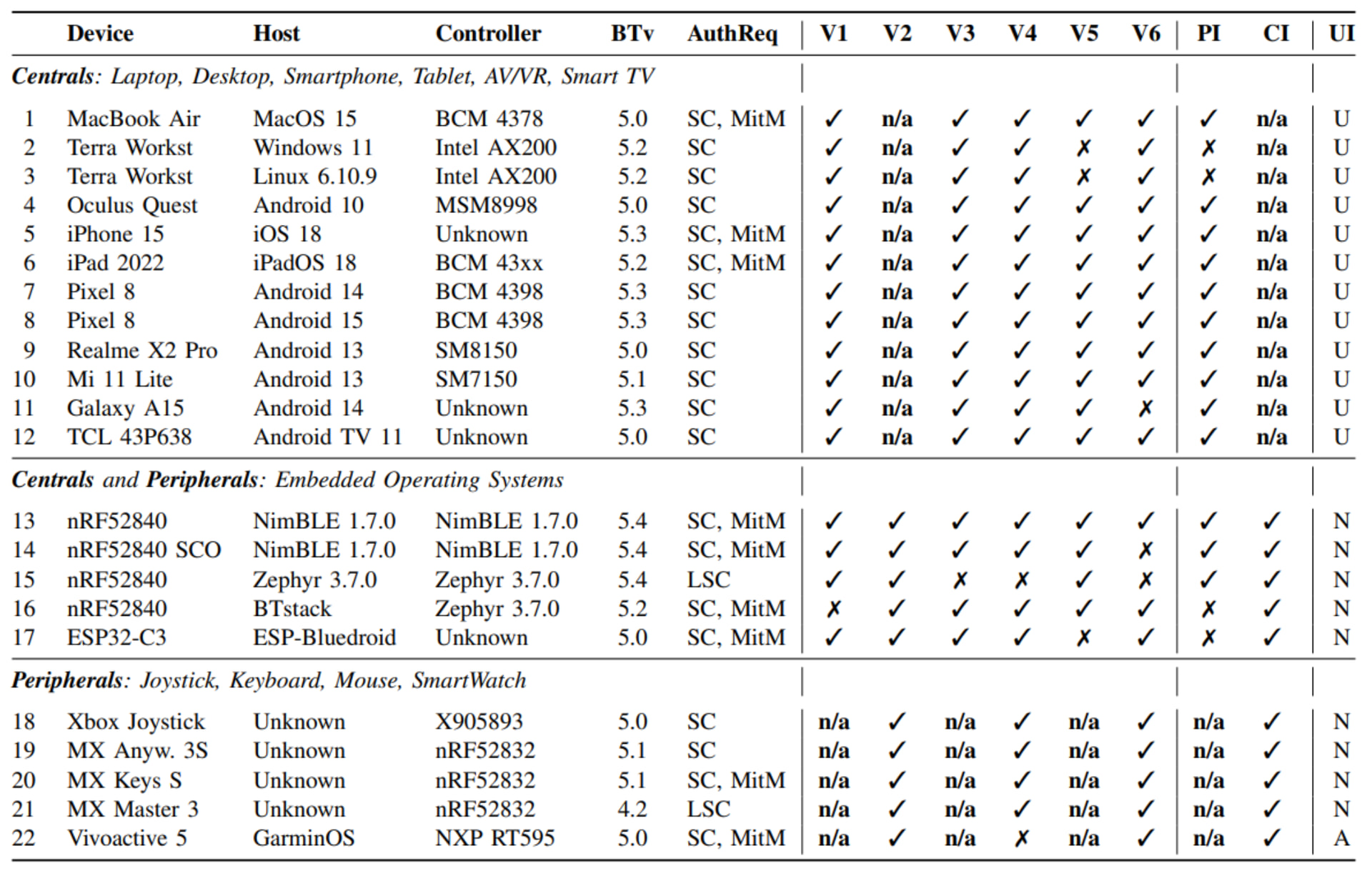

22 devices tested across BT 4.2–5.4, including the most secure configurations (SC, SCO, authenticated pairing), and… → All vulnerable!:

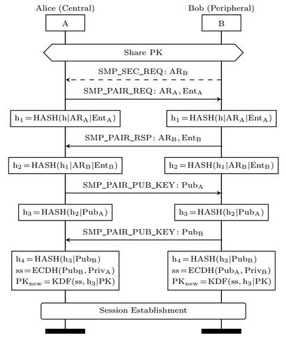

Defense
They propose two complementary fixes: hardened re-pairing (backward-compatible, stricter checks on security level consistency + mandatory disconnect on encryption failure, fixes V3–V6) and authenticated re-pairing (key chaining where new PK is derived from old PK + fresh ECDH, plus transcript hashing, verified with ProVerif, fixes everything but requires a standard update).
Hardened re-pairing alone doesn’t fix V1/V2 (the lack of authentication), so an attacker can still force a security upgrade and then attack the association phase
