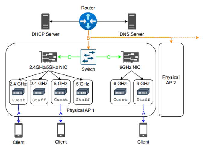

3 layers of failure
The authors structured their analysis around three boundaries where client isolation should be enforced but often isn’t:
Layer Boundary What’s checked
A: Wi-Fi Encryption Over-the-air frame protection GTK/PTK key management, shared passphrases
B: IP Routing Gateway/router forwarding rules L3 packet routing between clients
C: L2 Switching Internal AP bridge/switch MAC-to-port forwarding tables
Most vendors only enforce isolation at one of these layers, typically L2, while completely ignoring the others. Even within a single layer, enforcement is often inconsistent across BSSIDs, frequency bands, and guest/main network boundaries.

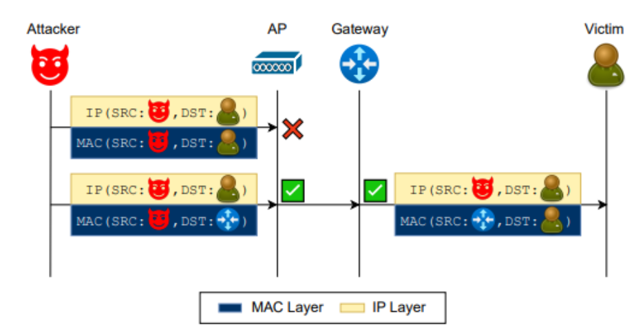

Gateway Bouncing: the L3 bypass
Many vendors enforce client isolation at L2 (blocking direct frame forwarding between clients) but completely forget about L3. The attacker sends a packet with the victim’s IP address as destination but the gateway’s MAC address as the L2 destination:
Ethernet(src=attacker, dst=gateway) / IP(src=attacker, dst=victim)
The AP happily forwards it to the gateway (the L2 destination matches), and the gateway routes it right back to the victim (the L3 destination matches). The packet doesn’t get blocked by client isolation because at the MAC/Ethernet layer, it’s addressed to the gateway, not another client. Client-to-client injection achieved, no crypto tricks needed.
All WPA versions (Personal and Enterprise) are affected.
This can be tested using the following command:
./airsnitch.py wlan2 --c2c-ip wlan3 --no-ssid-check [--other-bss|--same-bss]
Vulnerable if you see: >>> Client to client traffic at IP layer is allowed

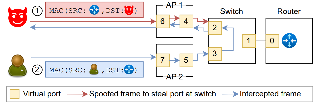

Port Stealing: hijacking the AP’s internal switch
Every BSSID on a Wi-Fi AP maps to a virtual port on the AP’s internal software switch. The attacker connects to a different BSSID than the victim, but uses the victim’s MAC address during association. This triggers the AP’s L2 learning process to remap the victim’s MAC to the attacker’s virtual port. All traffic destined for the victim is now forwarded to the attacker, encrypted with the attacker’s own PTK.
The root cause is a decoupling between L2 forwarding (which port a packet exits from) and cryptographic association (which PTK encrypts it). The AP updates the <MAC, PTK> binding to the latest handshake, regardless of which BSSID it occurred on.
In the worst case, if the attacker connects via an open/unencrypted SSID, traffic that was originally protected by WPA2/3 encryption gets forwarded in plaintext over the attacker’s unprotected BSSID. This was confirmed in real university network tests.
The uplink variant spoofs the gateway’s MAC address while connecting as a wireless client, causing all victim uplink traffic to be redirected to the attacker. Surprisingly, many implementations allow this even when other client-to-client traffic is blocked.
The original MacStealer tool only covered port stealing within a single BSSID for downlink interception. AirSnitch extends it to cross-BSSID, cross-AP, and uplink scenarios. Patching the original MacStealer flaw may ultimately require both APs and clients to implement the “Reassociating STA recognition” extension to IEEE 802.11, while most new AirSnitch issues are implementation/configuration flaws that are easier to fix.
To test downlink port stealing:
./airsnitch.py wlan2 --c2c-port-steal wlan3 --no-ssid-check --other-bss --server 8.8.8.8
Vulnerable if you see: >>> Downlink port stealing is successful.
Note: --same-bss doesn’t make sense here. Both devices would share the same MAC on the same BSSID and kick each other off.
And for the uplink:
./airsnitch.py wlan2 --c2c-port-steal-uplink wlan3 --no-ssid-check [--other-bss|--same-bss] [--server 1.2.3.4]
Vulnerable if you see: >>> Uplink port stealing is successful.
Unlike downlink, both --same-bss and --other-bss are worth testing here — results vary by vendor.
(source: GitHub - vanhoefm/airsnitch)
