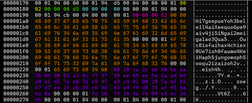

Compared to Windows BitLocker that uses command 0x00000158 for TPM2_Unseal,LUKS on this Moxa device uses 0x0000014E for TPM2_NV_Read:
  1. The key is stored directly in a TPM NV index, not sealed as an object like the Volume Master Key (VMK) in BitLocker
  2. What comes back is the actual LUKS passphrase (here a 128-byte ASCII string), not an intermediate key, so a little more straight forward than decrypting the Full Volume Encryption Key (FVEK) with the VMK to finally decrypt the disk
  3. PCR policy still gates access, but the mechanism is NV read authorization rather than unsealing
In this nice read, we can discover that the key (in orange) is directly joined after the policy-protected NV index using the TPM2_NV_Read command:

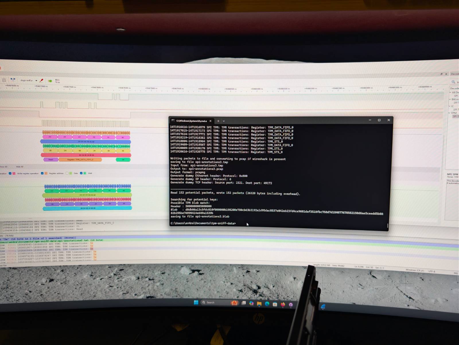

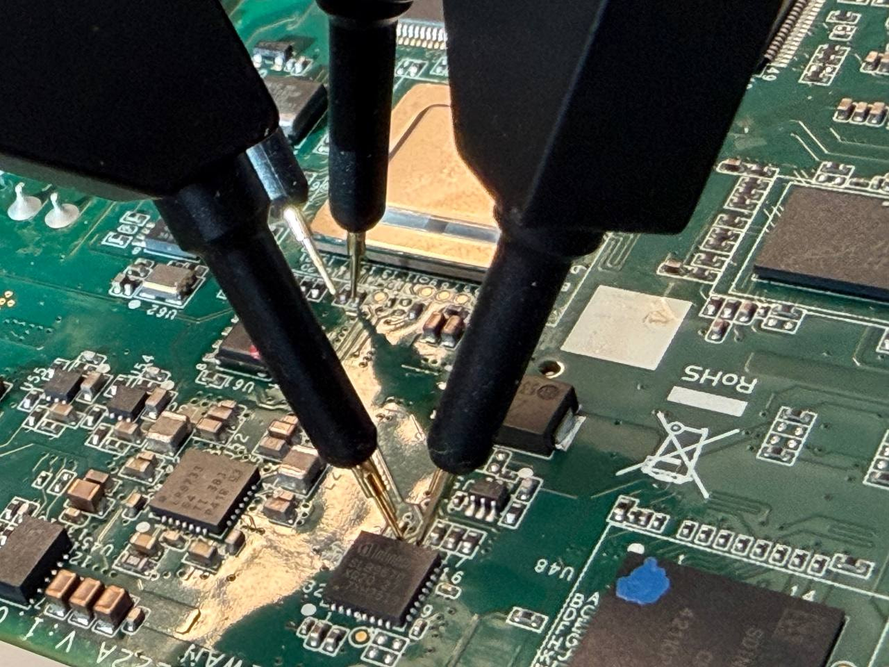

I recently tested Sipeed’s SLogic16U3 logic analyser which costs about £80. It seemed a bit fussy about USB ports as it didn’t like the usb-c port of my laptop but the usb-a port worked. I was sucessful in sniffing a test dell laptop in TPMandPIN mode.
So the cost of this attack is now as low as £80.

Excellent Robin! And already looking forward the end of the weekend to try that. I guess we can probably lower the cost using a RPi pico waiting for the TPM 2.0 commands from SPI instead of LPC like used in the pico-tpmsniffer and parsing.
On next rfswift.io image I will integrate your tooling which could be very handy and will soon be used. I hope also people will be able to contribute after watching it and improve it over the time. I need to split it to propose your libsigrokdecoder_spi-tpm for people just wanting to analyze with DSView and so.
