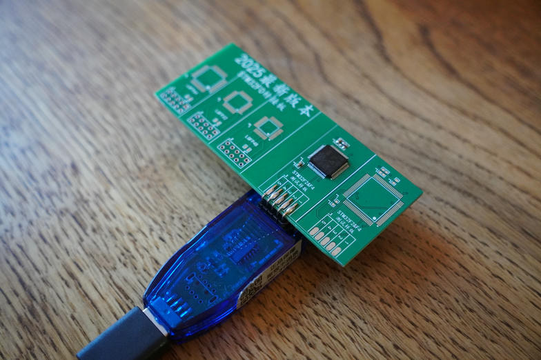

Karolis Stasaitis (@carlossless) recently documented something interesting: while browsing Xianyu (闲鱼, China’s second-hand marketplace), he found a whole market of turnkey STM32 RDP1 “decryptors”: search for “STM32解密” and you’ll see dozens of listings.

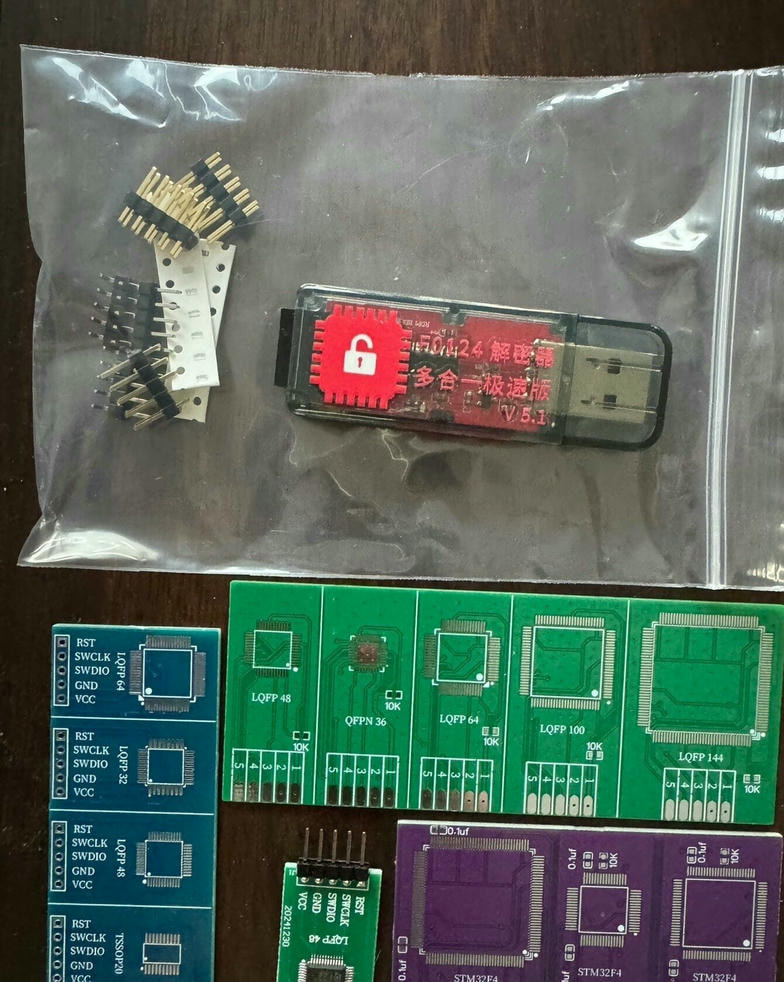

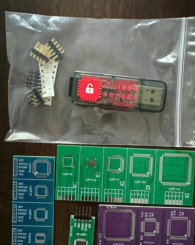

For about 150 yuan (~19 EUR), you get a USB dongle, adapter PCBs for F0/F1/F2/F4 packages, and a Windows utility. Solder the chip on the adapter, plug it in, click a button → full flash dump. No glitching rig, no tuning parameters, no understanding the underlying attack. It just works.

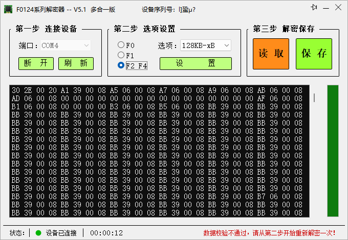

He tested it on an STM32F205RBT6 with RDP Level 1 enabled and got a clean 128KB flash readout at room temperature: the seller’s recommendation to use freeze spray wasn’t even necessary. The only quirk was the tool overshooting past the flash boundary and padding with 0xFF, but the actual contents were correct.
The dongle has an SOP-16 IC with its markings scraped off, and the Windows app triggers Defender and requires Chinese Simplified encoding to run, so the UX isn’t exactly polished. But the point stands: what took research labs, custom rigs, and careful timing a few years ago is now a commodity product on a Chinese flea market.
